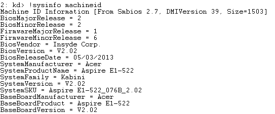

    Well, first off, the bug check seems to consistently be MULTIPLE_IRP_COMPLETE_REQUESTS (44).
    -- A driver has called IoCompleteRequest to ask that an IRP be completed, but the packet has already been completed.

    Update #5 - Wow, today I woke up to multiple emails from various people either providing their kernel-dumps, or asking if I'd like theirs. This is absolutely incredible, I am ecstatic. I'd like to extend a HUGE thank you to every single one of you. At the end of it all, I will be absolutely sure to give credit to every single one of you by your name, etc. Let's get started!
    David Laverdiere II's kernel-dump:
    This is the first kernel-dump I received, so it's only fair I use it in the first major analysis to check for consistency : )
    First off, let's take a look at the call stack just to see what's going on:

    From this call stack, we can see various networking related calls and routines.
    1. For example, very early on in the stack we have two afd.sys routine calls, which is the Ancillary Function Driver. Ancillary Function Driver (AFD) is the pilot auxiliary function, a Microsoft Windows service, responsible to the BSD socket function. Windows (see Winsock), the most famous application that uses sockets is Apache.
    In the Windows GUI, setting AFD is via the Device Manager (devmgmt.msc) and not in services and applications (services.msc). It is displayed in the list of Non-Plug and Play drivers, as the Environment network support (AFD AFD Networking Support Environment).
    2. As we move up the call stack, we go into many tcpip.sys (TCP/IP Protocol driver) routines. This is self explanatory.
    3. We then have one single ndis.sys (Network Driver Interface Specification driver) routine call. The Network Driver Interface Specification (NDIS) is an application programming interface (API) for network interface cards (NICs). The NDIS forms the Logical Link Control (LLC) sublayer, which is the upper sublayer of the OSI data link layer (layer 2). Therefore, the NDIS acts as the interface between the Media Access Control (MAC) sublayer, which is the lower sublayer of the data link layer, and the network layer (layer 3).
    The NDIS is a library of functions often referred to as a "wrapper" that hides the underlying complexity of the NIC hardware and serves as a standard interface for level 3 network protocol drivers and hardware level MAC drivers. Another common LLC is the Open Data-Link Interface (ODI).
    4. We then of course have our three HamDrv.sys (LogMeIn Hamachi Virtual Miniport) driver calls.
    5. Finally, we then have our inevitable bug check itself.
    Moving on, something very interesting in David's kernel-dump is this:
    ADDITIONAL_DEBUG_TEXT: USB\VID_04F2&PID_B374
    What does this mean? Well, this is a USB device. VID = Vendor ID, and PID = Product ID. As we can see here in this case, the VID = 04F2 and the PID = B374. As of right now, this doesn't really tell us anything other than a bunch of numbers which isn't very helpful. However, these numbers are actually very important!
    If we run them against a VID/PID database, we see that the 04F2 VID = Chicony Electronics Co., Ltd. Great, so we have a vendor! Now, what about the product? Unfortunately, there doesn't seem to be anything in a database for PID B374. With this said, I went to Google and hoped for the best. With very little searches available, the best guess would be to assume that this is a Chicony webcam and/or camera based device. I will have to ask David. Moving on...
    1: kd> dt nt!_IO_STATUS_BLOCK ffffe00007e7e2a0
    +0x000 Status : 0n18350086
    +0x000 Pointer : 0x00000001`01180006 Void
    +0x008 Information : 0xffffe000`00b69b10
    Now that we have this, let's check the STATUS field layout:
    1: kd> ? 0n18350086
    Evaluate expression: 18350086 = 00000000`01180006
    Let's go forward more:
    1: kd> .formats 0n18350086
    Hex: 00000000`01180006
    Decimal: 18350086
    Octal: 0000000000000106000006
    Binary: 00000000 00000000 00000000 00000000 00000001 00011000 00000000 00000110
    Chars: ........
    Time: Sat Aug 01 05:14:46 1970
    Float: low 2.7918e-038 high 0
    Double: 9.06615e-317
    Assuming I am correct, '00000000`01180006' falls under:
    NT_SUCCESS(Status) Evaluates to TRUE if the return value specified by Status is a success type (0 ? 0x3FFFFFFF) or an informational type (0x40000000 ? 0x7FFFFFFF). This is different than our first kernel as the first kernel returned NT_ERROR as opposed to NT_SUCCESS).
    Moving forward, let's take a closer look at the IRP:
    1: kd> !irp ffffe00007e7e2a0 1
    Irp is active with 1 stacks 3 is current (= 0xffffe00000d39070)
    Mdl=ffffe00000b69b10: No System Buffer: Thread fffff802ef8af540: Irp is completed. Pending has been returned
    Flags = 00060900
    ThreadListEntry.Flink = ffffe000016fb590
    ThreadListEntry.Blink = ffffe000076866d8
    IoStatus.Status = 00000000
    IoStatus.Information = 00000054
    RequestorMode = 00000001
    Cancel = 00
    CancelIrql = 0
    ApcEnvironment = 00
    UserIosb = 01471f40
    UserEvent = ffffe00001136790
    Overlay.AsynchronousParameters.UserApcRoutine = 00000000
    Overlay.AsynchronousParameters.UserApcContext = 01471f40
    Overlay.AllocationSize = 00000000 - 00000000
    CancelRoutine = fffff800045c188c Hamdrv
    UserBuffer = 00000000
    &Tail.Overlay.DeviceQueueEntry = ffffe00007e7e318
    Tail.Overlay.Thread = fffff802ef8af540
    Tail.Overlay.AuxiliaryBuffer = fffff802efdd78dc
    Tail.Overlay.ListEntry.Flink = 00000000
    Tail.Overlay.ListEntry.Blink = 00000000
    Tail.Overlay.CurrentStackLocation = ffffe00000d39070
    Tail.Overlay.OriginalFileObject = 00000000
    Tail.Apc = 00580012
    Tail.CompletionKey = 00580012
    cmd flg cl Device File Completion-Context
    [ 3, 0] 0 0 ffffe000029bf900 00000000 00000000-00000000
    \Driver\hamachi
    Args: 00000000 00000000 00000000 00000000
    Great, we're consistent here. The IRP is completed and the pending has returned. We also appear to have the same # (3) which appears to be the Major Function Code for IRP_MJ_READ and the same for the Minor Function Code, which is IRP_MN_NORMAL. Let's go ahead and take 'ffffe000029bf900' and look into it:
    1: kd> !devstack ffffe000029bf900
    !DevObj !DrvObj !DevExt ObjectName
    > ffffe000029bf900 \Driver\hamachi ffffe000029bfa50 HamachiTap.FBA77CC0-00D0-459A-AEA1-63052984BC34
    Very nice, more Hamachi. Let's now go ahead and take 'ffffe00000d39070' (CurrentStackLocation) and look into it:
    1: kd> dt nt!_IO_STACK_LOCATION 0xffffe00000d39070
    +0x000 MajorFunction : 0x5 ''
    +0x001 MinorFunction : 0 ''
    +0x002 Flags : 0xd8 ''
    +0x003 Control : 0 ''
    +0x008 Parameters : <unnamed-tag>
    +0x028 DeviceObject : (null)
    +0x030 FileObject : (null)
    +0x038 CompletionRoutine : (null)
    +0x040 Context : (null)
    Yes, more consistency! Remember, the data structure shows the current stack location of the IRP. Since IRPs can be handled by different Driver Objects through Driver Stacks, and therefore may be a indication of the different driver handling a different IRP. Moving on...
    1: kd> !drvobj ffffe00005c66230 f
    Driver object (ffffe00005c66230) is for:
    \Driver\hamachi
    Driver Extension List: (id , addr)
    (4e4d4944 ffffe000010b5810)
    Device Object list:
    ffffe000029bf900 ffffe000075cf050
    Let's take 'ffffe000075cf050' (part of the Device Object list) and look into it:
    1: kd> !devobj ffffe000075cf050
    Device object (ffffe000075cf050) is for:
    NDMP18 \Driver\hamachi DriverObject ffffe00005c66230
    Current Irp 00000000 RefCount 0 Type 00000017 Flags 00002050
    Dacl ffffc10100d9bf51 DevExt ffffe000075cf1a0 DevObjExt ffffe000075d0720
    ExtensionFlags (0x00000800) DOE_DEFAULT_SD_PRESENT
    Characteristics (0x00000100) FILE_DEVICE_SECURE_OPEN
    AttachedTo (Lower) ffffe00007098e50 \Driver\PnpManager
    Device queue is not busy.
    More consistency! Let's keep going...
    1: kd> !devstack ffffe000075cf050
    > ffffe000075cf050 \Driver\hamachi ffffe000075cf1a0 NDMP18
    ffffe00007098e50 \Driver\PnpManager 00000000 000000a4
    !DevNode ffffe00000c15d30 :
    DeviceInst is "ROOT\NET\0000"
    ServiceName is "Hamachi"
    More and more consistency! Also, if you've been noticing, I have been highlighting NDMP(n) as we've been going through this. The reason for this is NDMP(n) = Network Data Management Protocol, which is a protocol invented by the NetApp and Legato companies, meant to transport data between network attached storage (NAS) devices and backup devices. This removes the need for transporting the data through the backup server itself, thus enhancing speed and removing load from the backup server.
    This is likely why we see so many network related routines in the call stack which was inevitably responsible for the IRP.
    Let's now go ahead and run a !thread on the thread in which the IRP completed:
    1: kd> !thread fffff802ef8af540
    fffff802ef8af540 is not a thread object, interpreting as stack value...
    TYPE mismatch for thread object at fffff802ef8af540
    Oh no! We've reached a very unfortunate dead end in David's kernel-dump. After debugging for over an hour, I was not about to give up. I went ahead and opened up another kernel-dump (provided by Maximilian Kless), and quickly got to where we are. The thread extension worked this time!
    2: kd> !thread ffffe00004edd880
    THREAD ffffe00004edd880 Cid 08a0.0968 Teb: 00007ff63f615000 Win32Thread: fffff901400f86d0 RUNNING on processor 3
    IRP List:
    ffffe00005a625b0: (0006,0118) Flags: 00060000 Mdl: 00000000
    ffffe00005a2c1e0: (0006,0118) Flags: 00060000 Mdl: 00000000
    ffffe00002904cc0: (0006,01f0) Flags: 00060900 Mdl: 00000000
    ffffe000025cc270: (0006,01f0) Flags: 00060800 Mdl: 00000000
    Not impersonating
    DeviceMap ffffc0000000c250
    Owning Process ffffe00004bd0900 Image: hamachi-2.exe
    Attached Process N/A Image: N/A
    Wait Start TickCount 227813 Ticks: 0
    Context Switch Count 8289 IdealProcessor: 0
    UserTime 00:00:00.281
    KernelTime 00:00:00.406
    Win32 Start Address 0x00007ffe21c281b0
    Stack Init ffffd00035a46c90 Current ffffd00035a45fe0
    Base ffffd00035a47000 Limit ffffd00035a41000 Call 0
    Priority 8 BasePriority 8 UnusualBoost 0 ForegroundBoost 0 IoPriority 2 PagePriority 5
    Child-SP RetAddr : Args to Child : Call Site
    00000000`01f8f7e0 00000000`00000000 : 00000000`00000000 00000000`00000000 00000000`00000000 00000000`00000000 : 0x00007ff6`40361752
    At this point, I am honestly jumping up and down in my chair. We see a huge consistency here, and we have one more step to go. Let's finally go ahead and run an !irp on the 3rd value in the IRP list:
    2: kd> !irp ffffe00002904cc0
    Irp is active with 2 stacks 2 is current (= 0xffffe00002904dd8)
    No Mdl: No System Buffer: Thread ffffe00004edd880: Irp stack trace.
    [ 0, 0] 0 0 00000000 00000000 00000000-00000000
    >[ 3, 0] 0 1 ffffe00001f37060 ffffe00005de5f20 00000000-00000000 pending
    \FileSystem\Npfs
    Args: 00002000 00000000 00000000 00000000
    And that's it, we have consistency! Npfs.sys marked as status PENDING in TWO kernel dumps on TWO ENTIRELY different systems. Also, even though David's kernel-dump didn't show us a !thread, it showed alarming consistency in regards to many other things seen in the dump itself.
    Now, with all of this found, I will bring it up to Harry and my fellow analysts, and see if we can explain what role Npfs.sys has in these crashes. More updates to come! I will of course also take a look at the other kernel-dumps I was provided. Busy busy day.
    Update #6 - This is not an analysis update, mostly because the analysis is finished. From this point on, it's of course up to LogMeIn to examine their driver code and see why things like Npfs.sys remain PENDING, etc.
    Aside from receiving any new kernel-dumps from any kind individuals to quickly check for consistency, Harry (x BlueRobot) and I have analyzed this to the point where we can do no more as we are only volunteer analysts with an interest in helping people. This update is instead directed more towards how much of a huge thank you I want to extend.
    First off, I simply couldn't have done a large amount of this without Harry's help. As much as I appreciate all of the recognition I am receiving for this, Harry deserves it just as much as I do. It would have taken me a very long time and it would have been very stressful. Harry provided tons of documentation and debugging related information, and both of us have learned a very large amount from this. So far I have worked on two bugs with him (HP-Envy-700-074 BIOS bug) and now this. So far, both have been extremely successful.
    I'd also like to thank ZigZag3143 for not only submitting tickets and remaining in contact with LogMeIn, and providing up to date threads across various communities displaying the sheer number of people having this problem, but for being a good friend as always and lending a hand.
    Next, I'd like to of course extend an extremely large thanks to everyone around the world who has sent me their kernel-dumps simply because they wanted to be a part of this and help contribute to solving the issue. I am going to be making a list of the people who contributed their kernel-dumps, by name. As I am still receiving (or waiting to receive) kernel-dumps from various people who've contacted me, it will likely be an ongoing list.
    Essentially, what I am trying to convey here is that this was not just me, it was a huge team effort. I had tons of help from Harry, and extremely kind people from all around the world. I truly appreciate situations like this more than anything in life, because they are very important. As an analyst with a huge passion in debugging, this was not only a beautiful learning experience, but I got to work with a lot of extremely great people. It truly goes to show that when people work together, you can essentially solve any problem.
    Update #7 - It appears as I stated at the very top that this bug has been SOLVED! Again, a huge thank you to everyone involved, and to LogMeIn for fixing it promptly for its customers.
    Source
