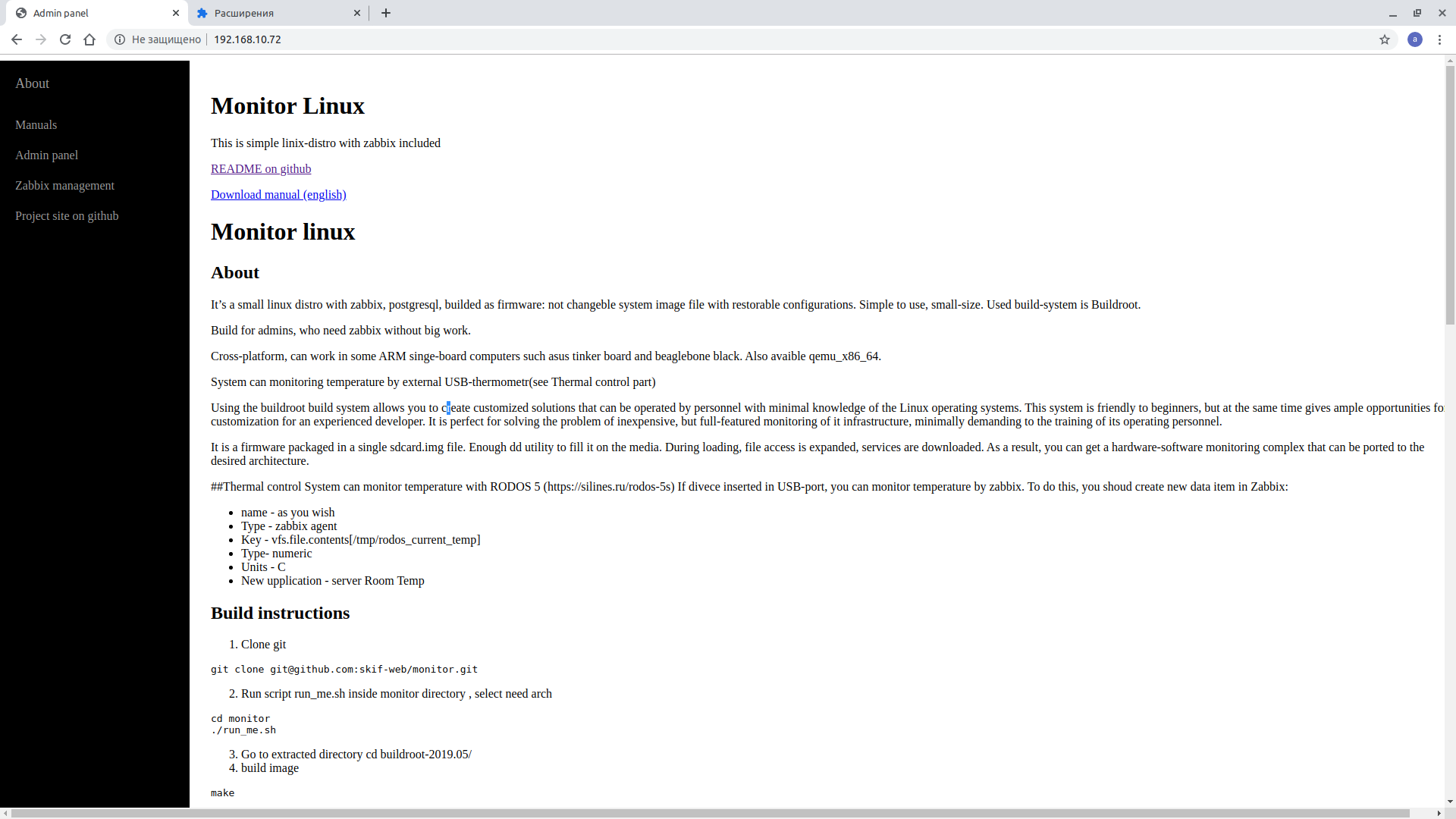

Main system management way is through web-interface. It available by accessing recieved ip address (see boot part).
0*HjwHdJQtNAVdCTH3
  • Admin panel — web-interface for device manage http://${system_ip}/manage
  • Zabbix management — Zabbix native web-interface http://${system_ip}/zabbix
  • About page http://${system_ip}
Default user-pass for ssh and web-console is root:admin. Default zabbix web-interface credentials is Admin:zabbix.

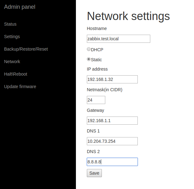

Admin panel
Open in web-browser: http://${system_ip}/manage
Available functions:
  • System status: uptime, load average, free memory, free disk space
  • Network settings: hostname, static/dhcp IP4 settings
  • Admin password
  • Backup/restore (settings and database dump separately), factory reset
NOTE Warning! Factory reset destroy ALL data!!!
Restore and Reset operations need reboot after them.

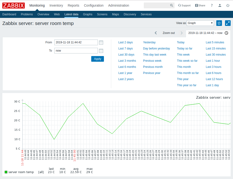

Temperature control

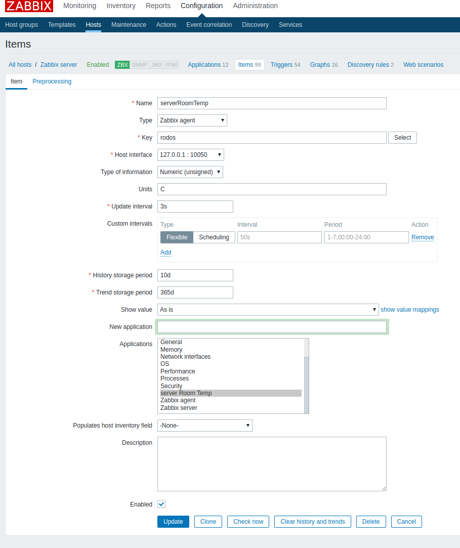

Temperature control use RODOS-5 usb thermometer. Its usb device with dallas 1820. Of course, i know, that dallas 1820 can bi user directly, but you may need to buy 1-wire device (if not exist on your board).
Steps to enable thermal control:
  1. insert device to usb port
  2. Create data item in zabbix:
  3. Configuration -> Hosts
  4. Click ITEMS in your server line
  5. Click “Create item” button
- name — serverRoomTemp
- Type — zabbix agent
- Key — rodos
- Type- numeric
- Units — C
- History storage period — 10 days
- Trend storage period — 30 days
- New application — server Room Temp
- Click ADD button
Temperature graph:
