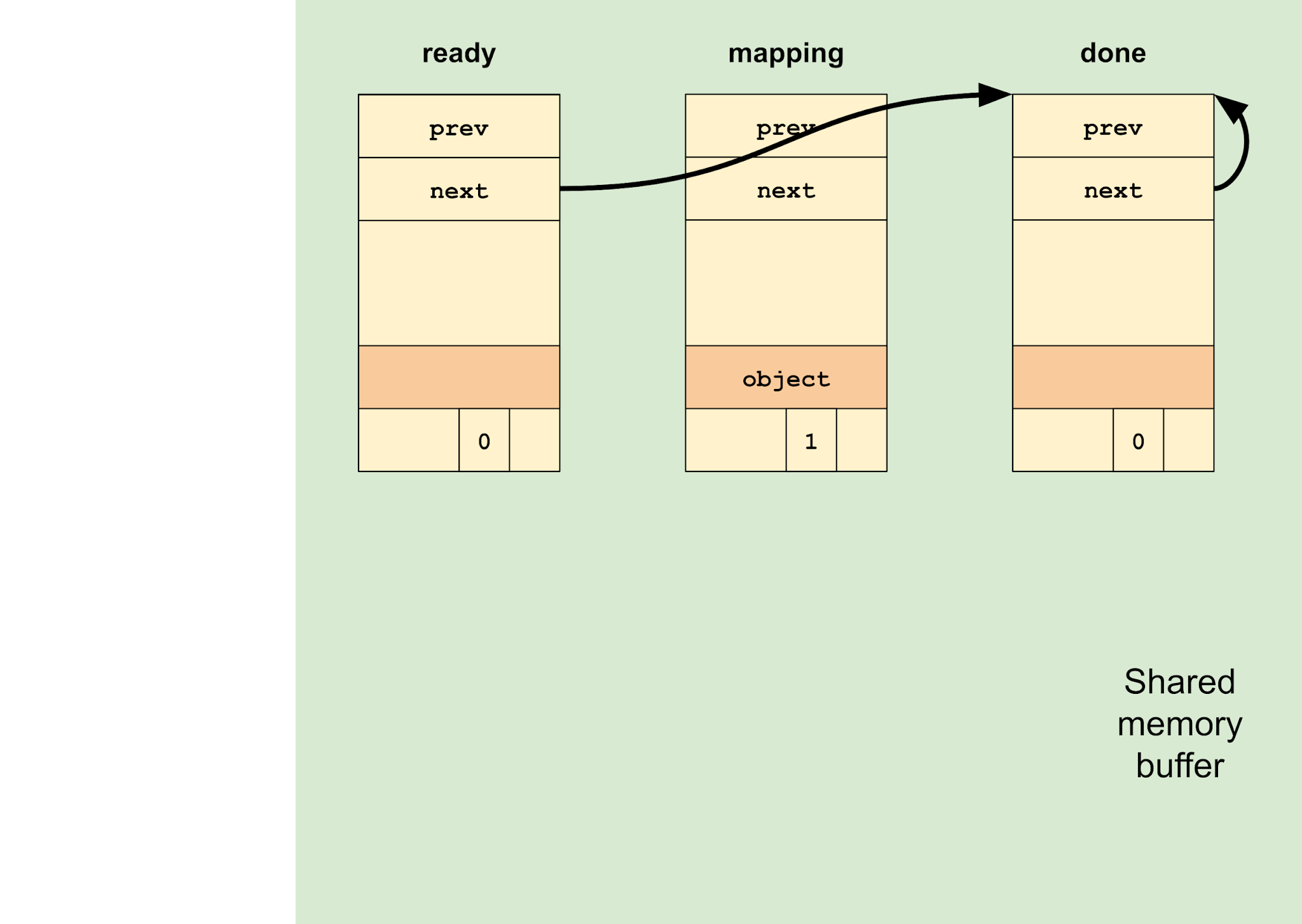

With kernel read/write and a user/kernel shared memory buffer in hand, we are ready to write the POC. The overall flow of the exploit is essentially what was outlined above.
We start by creating the shared memory region in the kernel.

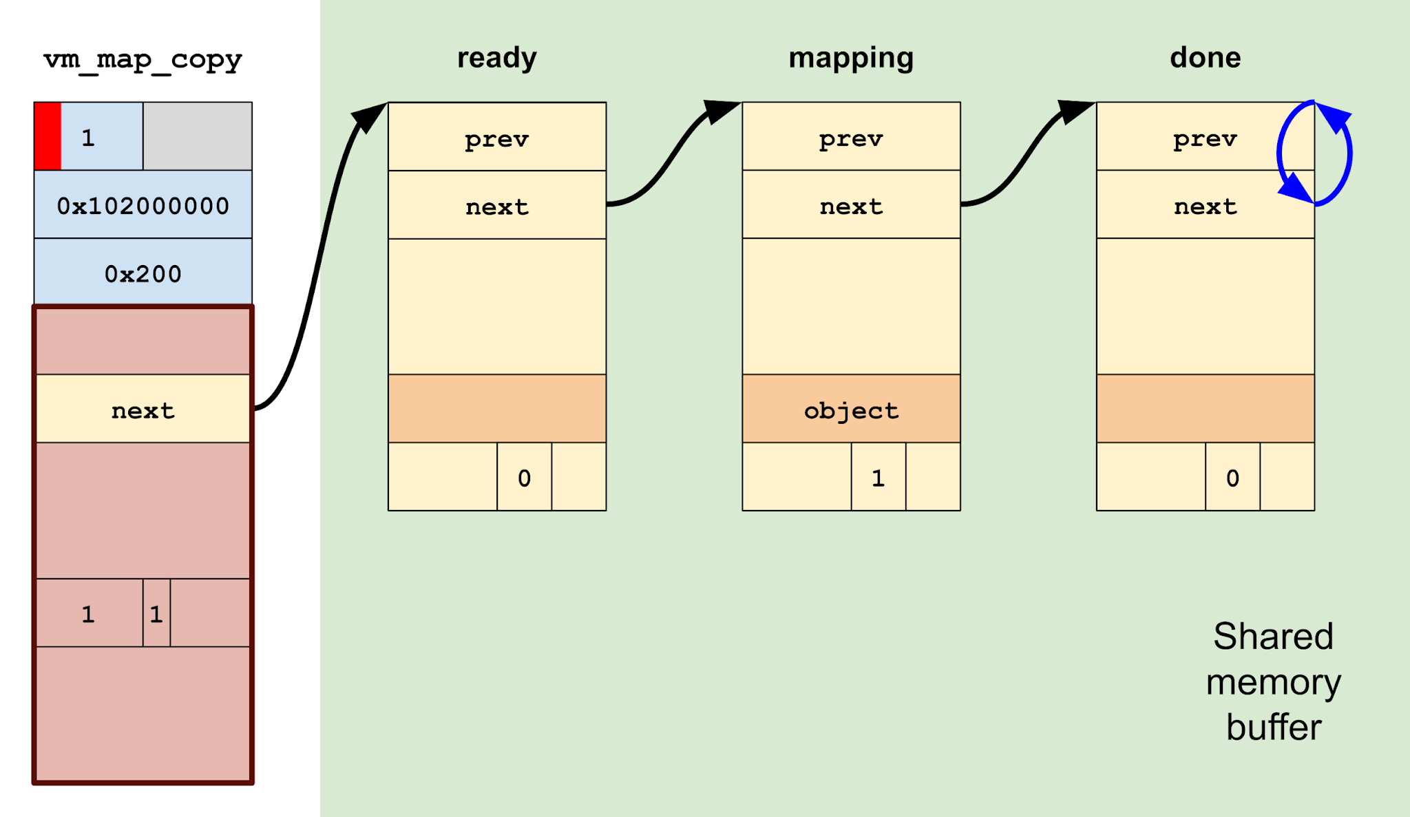

We initialize a fake vm_map_entry list inside the shared memory. The entry list contains 3 entries: a "ready" entry, a "mapping" entry, and a "done" entry. Together these entries will represent the current state of each mapping operation.
We send an out-of-line memory descriptor containing a fake vm_map_header in a Mach message to a holding port. The out-of-line memory is stored in the kernel as a vm_map_copy object of type KERNEL_BUFFER (value 3).
We simulate a one-byte linear heap overflow that corrupts the type field of the vm_map_copy, changing it to ENTRY_LIST (value 1).

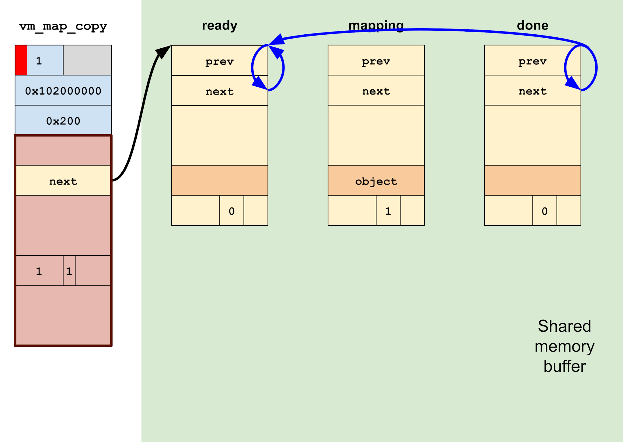

We start a thread that receives the Mach message queued on the holding port. This triggers a call to vm_map_copyout_internal() on the corrupted vm_map_copy.
Due to the way the vm_map_entry list was initially configured, the vm_map_copyout thread will spin in an infinite loop on the "done" entry, ready for us to manipulate it.
At this point, we have a kernel thread that is spinning ready to map any physical page we request.
To map a page, we first set the "ready" entry to link to itself, and then set the "done" entry to link to the "ready" entry. This will cause the vm_map_copyout thread to spin on "ready".
While spinning on "ready", we mark the "mapping" entry as wired with a single physical page and link it to the "done" entry, which we link to itself. We also populate the fake vm_object and vm_page to map the desired physical page number.
Then, we can perform the mapping by linking the "ready" entry to the "mapping" entry. vm_map_copyout_internal() will map in the page and then spin on the "done" entry, signaling completion.
This gives us a reusable primitive that maps arbitrary physical addresses into our process. As an initial proof of concept, I mapped the non-existent physical address 0x414140000 and tried to read from it, triggering an LLC bus error from EL0:

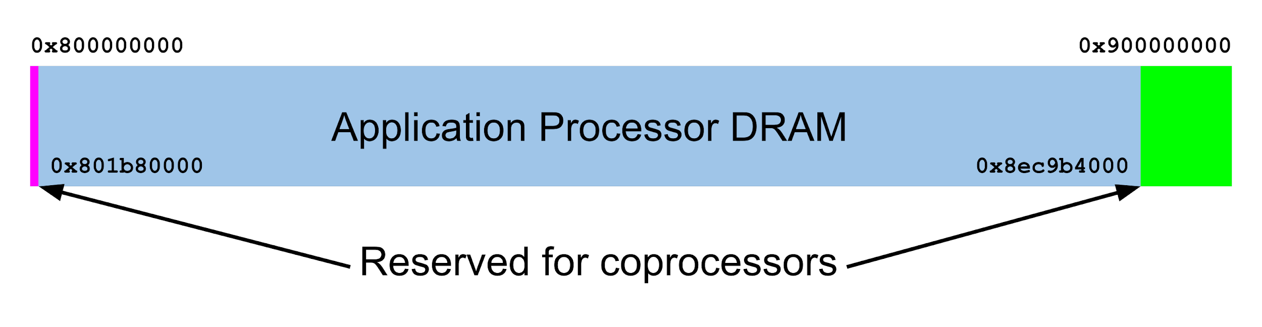

But first, before we figure out how to locate the kernelcache, some background on physical memory on the iPhone 11 Pro.
The iPhone 11 Pro has 4 GB of DRAM based at physical address 0x800000000, so physical DRAM addresses span 0x800000000 to 0x900000000. Of this, the range 0x801b80000 to 0x8ec9b4000 is reserved for the Application Processor (AP), the main processor of the phone which runs the XNU kernel and applications. Memory outside this region is reserved for coprocessors like the Always On Processor (AOP), Apple Neural Engine (ANE), SIO (possibly Apple SmartIO), AVE, ISP, IOP, etc. The addresses of these and other regions can be found by parsing the devicetree or by dumping the iboot-handoff region at the start of DRAM.
At boot time, the kernelcache is loaded contiguously into physical memory, which means that finding a single kernelcache page is sufficient to locate the whole image. Also, while KASLR may slide the kernelcache by a large amount in virtual memory, the load address in physical memory is quite constrained: in my testing, the kernel header was always loaded at an address between 0x805000000 and 0x807000000, a range of just 32 MB.
As it turns out, this range is smaller than the kernelcache itself at 0x23d4000 bytes, or 35.8 MB. Thus, we can be certain at runtime that address 0x807000000 contains a kernelcache page.

Yet, that's not quite true. The Application Processor's DRAM region might be a minefield, but anything outside of it is not. That includes the DRAM used by coprocessors and also any other addressable components of the system, such as hardware registers for system components that are typically accessed via memory-mapped I/O (MMIO).
With such a powerful primitive, I expect that there are a plethora of techniques that could be used to build a read/write primitive. And I expect that there are many clever things that could be done by leveraging direct access to special hardware registers and coprocessors. Unfortunately, this is not an area with which I'm very familiar, so I'll just describe one (failed) attempt to bypass PPL here.
The idea I had was to take control of some coprocessor and use execution on both the coprocessor and the AP together to attack the kernel. First, we use the physical mapping primitive to modify the part of DRAM storing data for a coprocessor in order to get code execution on that coprocessor. Next, back on the main processor, we use the mapping primitive a second time to map and disable the coprocessor's Device Address Resolution Table, or DART (basically an IOMMU). With code execution on the coprocessor and the corresponding DART disabled, we have direct unguarded access from the coprocessor to physical memory, allowing us to completely sidestep the protections of PPL (which are only enforced from the AP).
However, whenever I tried to modify certain regions of DRAM used by coprocessors, I would get kernel panics. In particular, the region 0x800000000 - 0x801564000 appeared to be readonly:
panic(cpu 5 caller 0xfffffff0189fc598): "LLC Bus error from cpu1: FAR=0x16f507f10 LLC_ERR_STS/ADR/INF=0x11000ffc00000080/0x214000800000000/0x1 addr=0x800000000 cmd=0x14(acc_cifl2c_cmd_ncwr)"
panic(cpu 5 caller 0xfffffff020ca4598): "LLC Bus error from cpu1: FAR=0x15f03c000 LLC_ERR_STS/ADR/INF=0x11000ffc00000080/0x214030800104000/0x1 addr=0x800104000 cmd=0x14(acc_cifl2c_cmd_ncwr)"
panic(cpu 5 caller 0xfffffff02997c598): "LLC Bus error from cpu1: FAR=0x10a024000 LLC_ERR_STS/ADR/INF=0x11000ffc00000082/0x21400080154c000/0x1 addr=0x80154c000 cmd=0x14(acc_cifl2c_cmd_ncwr)"
This was very weird: these addresses are outside of the KTRR lockdown region, so nothing should be able to block writing to this part of DRAM with a physical mapping primitive! Thus, there must be some other undocumented lockdown enforced on this physical range.
On the other hand, the region 0x801564000 - 0x801b80000 remains writable as expected, and writing to different areas in this region produces odd system behaviors, supporting the theory that this is corrupting data used by coprocessors. For example, writing to some areas would cause the camera and flashlight to become unresponsive, while writing to other areas would cause the phone to panic when the mute slider was switched on.
To get a better sense of what might be happening, I identified the regions in this range by examining the devicetree and dumping memory. In the end, I discovered the following layout of coprocessor firmware segments in the range 0x800000000 - 0x801b80000:
Thus, the regions that are locked down are all __TEXT segments of coprocessor firmwares; this strongly suggests that Apple has added a new mitigation to make coprocessor __TEXT segments read-only in physical memory, similar to KTRR on the AMCC (probably Apple's memory controller) but for coprocessor firmwares instead of just the AP kernel. This might be the undocumented CTRR mitigation referenced in the originally published xnu-6153.41.3 sources that appears to be an enhanced replacement for KTRR on A12 and up; Ian Beer suggested CTRR might stand for Coprocessor Text Readonly Region.
Nevertheless, code execution on these coprocessors should still be viable: just as KTRR does not prevent exploitation on the AP, the coprocessor __TEXT lockdown mitigation does not prevent exploitation on coprocessors. So, even though this mitigation makes things more difficult, at this point our plan of disabling a DART and using code execution on the coprocessor to write to a PPL-protected physical address should still work.

Suppose for the moment that we were able to break out of the for loop and allow vm_map_copyout_internal() to return. The call to vm_map_copy_insert() that occurs after the for loop walks through all the entries in the vm_map_copy, unlinks them from the vm_map_copy's entry list, and links them into the vm_map's entry list instead.
static void
vm_map_copy_insert(
    vm_map_t        map,
    vm_map_entry_t  after_where,
    vm_map_copy_t   copy)
    vm_map_entry_t  entry;
    while (vm_map_copy_first_entry(copy) !=
               vm_map_copy_to_entry(copy)) {
        entry = vm_map_copy_first_entry(copy);
        vm_map_copy_entry_unlink(copy, entry);
        vm_map_store_entry_link(map, after_where, entry,
            VM_MAP_KERNEL_FLAGS_NONE);
        after_where = entry;
    zfree(vm_map_copy_zone, copy);
Since the vm_map_copy's vm_map_entrys are all fake objects residing in shared memory, we really do not want them linked into our vm_map's entry list, where they will be freed on process exit. The simplest solution is thus to update the corrupted vm_map_copy's entry list so that it appears to be empty.
Forcing the vm_map_copy's entry list to appear empty certainly lets us safely return from vm_map_copyout_internal(), but we would nevertheless still get a panic once our process exits:

Finally, it is time to break vm_map_copyout_internal() out of the for loop.
    for (entry = vm_map_copy_first_entry(copy);
        entry != vm_map_copy_to_entry(copy);
        entry = entry->vme_next) {
The macro vm_map_copy_to_entry(copy) expands to:
    (struct vm_map_entry *)(&copy->c_u.hdr.links)
Thus, in order to break out of the loop, we need to process a vm_map_entry with vme_next pointing to the address of the c_u.hdr.links field in the corrupted vm_map_copy originally passed to this function.
The function is currently spinning on the "done" vm_map_entry, and we need to link in one final "overlay" vm_map_entry to address the pmap/vm_map accounting issue anyway. So the simplest way to break the loop is to modify the "overlay" entry's  vme_next to point to &copy->c_u.hdr.links. and then update the "done" entry's vme_next to point to the overlay entry.
The problem is the call to vm_map_copy_insert() mentioned earlier, which frees the vm_map_copy as if it were of  type ENTRY_LIST:
However, the object passed to zfree() is our corrupted vm_map_copy, which was allocated with kalloc(); trying to free it to the vm_map_copy_zone will panic. Thus, we somehow need to ensure that a different, legitimate vm_map_copy object gets passed to the zfree() instead.
Fortunately, if you check the disassembly of vm_map_copyout_internal(), the vm_map_copy pointer is spilled to the stack for the duration of the for loop!
FFFFFFF007C599A4     STR     X28, [SP,#0xF0+copy]
FFFFFFF007C599A8     LDR     X25, [X28,#vm_map_copy.links.next]
FFFFFFF007C599AC     CMP     X25, X27
FFFFFFF007C599B0     B.EQ    loc_FFFFFFF007C59B98
...                             ; The for loop
FFFFFFF007C59B98     LDP     X9, X19, [SP,#0xF0+dst_addr]
FFFFFFF007C59B9C     LDR     X8, [X19,#vm_map_copy.offset]
This makes it easy to ensure that the pointer passed to zfree() is a legitimate vm_map_copy allocated from the vm_map_copy_zone: just scan the kernel stack of the vm_map_copyout_internal() thread while it's still spinning and swap any pointers to the corrupted vm_map_copy with the legitimate one.
At last, we have fixed up the state enough to allow vm_map_copyout_internal() to break the loop and return safely.
