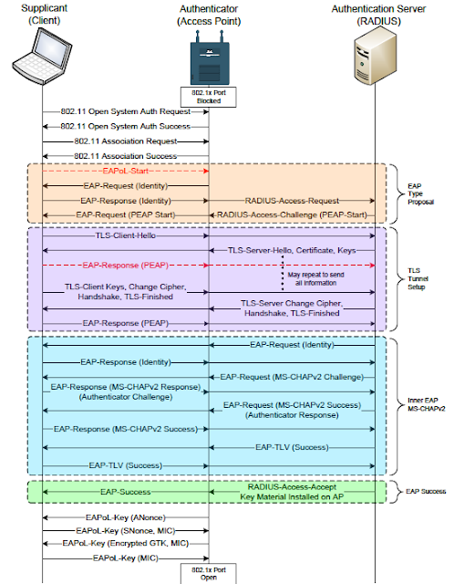

MS-CHAPv2 is only used in what we call "tunneled authentication protocols," which includes EAP-PEAPv0 and EAP-TTLS. These EAP protocol specifications acknowledge that many insecure and legacy authentication methods need protection and should not be used on their own. They deal with that by wrapping the insecure protocol inside of another, much more secure, TLS tunnel. Hence, these protocols are called "tunneled authentication protocols."
This tunneling occurs by relying on asymmetric cryptography through the use of X.509 certificates installed on the RADIUS server, which are sent to the client device to begin connection setup. The client verifies the certificate is valid (more on that in a second), and proceeds to establish a TLS tunnel with the server and begin using symmetric key cryptography for data encryption. Once the TLS tunnel is fully formed, the client and server use the less secure protocol such as MS-CHAPv2 to authenticate the client. This exchange is fully encrypted using the symmetric keys established during tunnel setup. The encryption switches from asymmetric key cryptography to symmetric key cryptography to ease processing and performance, which are much faster this way. This is fundamentally the same method used for HTTPS sessions in a web browser.
Here is a reference ladder diagram of PEAP authentication which highlights the different phases of the connection process (outer TLS tunnel setup and inner MS-CHAPv2 authentication).

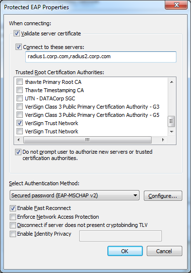

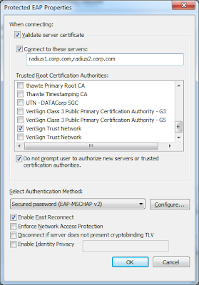

In Windows the RADIUS server validation is defined within each SSID profile. If you are looking directly on a Windows 7 workstation, you will want to view the SSID properties, select the Security tab, and go into the PEAP settings. Enable server validation, specify valid server names (which are checked against the Common Name - CN within the server certificate presented to the client), restrict which Root CAs the server certificate can be issued from, and prevent the system from prompting users to accept untrusted certificates (which is important, otherwise they could unknowingly accept a bad certificate and connect to an attacker's RADIUS server).

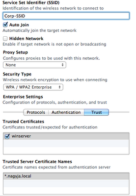

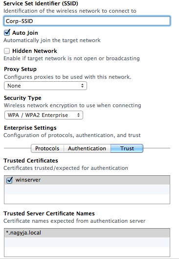

In Apple devices, including OS X Lion, Mountain Lion, and iOS, use the Lion Server Profile Manger or iPCU to define a configuration profile which includes credentials and a Wi-Fi policy. I'll show the iPCU in this example. First, add the Root CA certificate into the "Credentials" section. Next, define a Wi-Fi policy which specifies the trusted certificates and certificate names allowed.

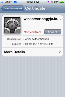

If no policy for the SSID has been defined or pushed to the client device by an administrator, the default behavior is to prompt the user to validate the certificate. This is likely not ideal, since users typically have a hard time distinguishing what a certificate means and whether or not they should proceed. For example, when an Apple iPhone attempts to join a network when no profile has been deployed for that SSID, the user receives a prompt to accept the connection and proceed:

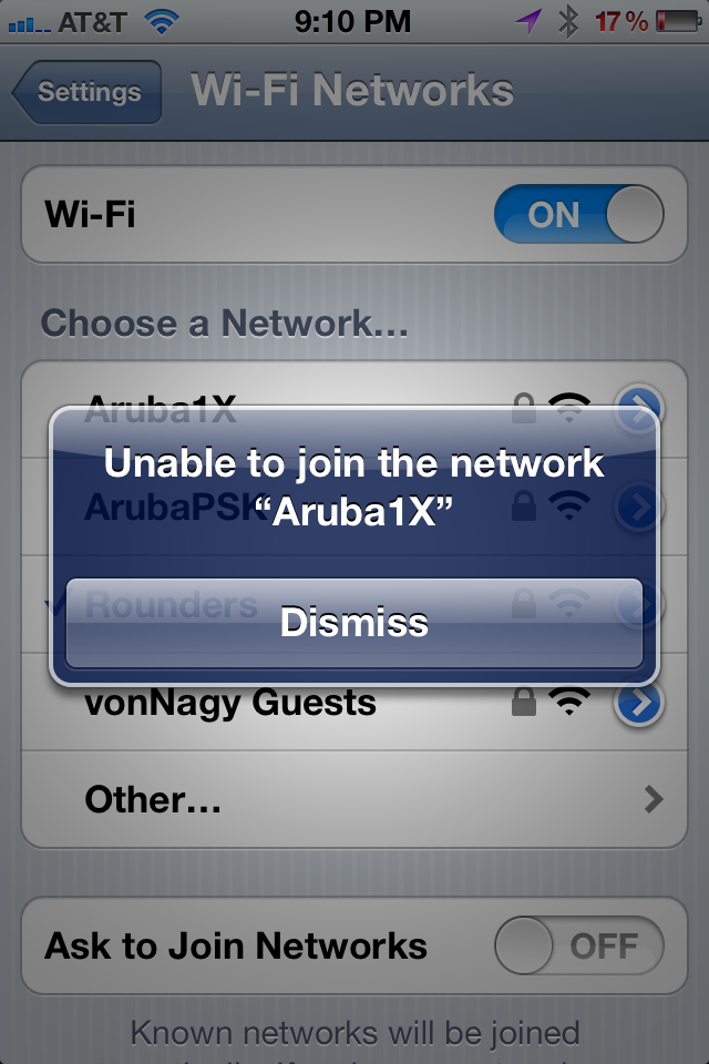

Therefore, for all corporate 802.1X environments, it is recommended to push profiles for all 802.1X SSIDs that end-users need on their systems. This goes for both production access and BYOD scenarios. The behavior on Windows 7, OS X Lion / Mountain Lion, and iOS devices when a profile has been installed for a specific SSID, is to check the local certificate store or keychain to validate the RADIUS server certificate. It must also match the Root CAs and server names specified in the deployed profile. In the event that an untrusted certificate is presented, all of these systems will NOT prompt the user and the connection is rejected. For example, here is rejected connection by an Apple iPhone for an SSID that has had a profile deployed by an administrator:
