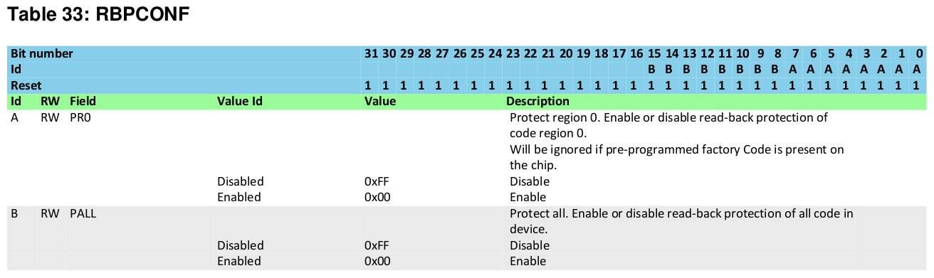

We can also read a few of the memory-mapped configuration registers. Here we are reading a register named "RBPCONF" (short for readback protection) in a collection of registers named "UICR" (User Information Configuration Registers); you can find the address of this register in the nRF51 Series Reference Manual:
> mdw 0x10001004
0x10001004: ffff00ff
According to the manual, a value of 0xffff00ff in the RBPCONF register means "Protect all" (PALL) is enabled (bits 15..8, labeled "B" in this table, are set to 0), and "Protect region 0" (PR0) is disabled (bits 7..0, labeled "A", are set to1):
The PALL feature being enabled is what is responsible for preventing us from accessing the code section and subsequently causing our read commands to return zeros.
The other protection feature, PR0, is not enabled in this case, but it's worth mentioning because the protection bypass discussed in this article could bypass PR0 as well. If enabled, it would prevent the debugger from reading memory below a configurable address. Note that flash (and therefore the firmware we want) exists at a lower address than RAM. PR0 also prevents code running outside of the protected region from reading any data within the protected region.
Unfortunately, it is not possible to disable PALL without erasing the entire chip, wiping away the firmware with it. However, it is possible to bypass this readback protection by leveraging our debug access to the CPU.
