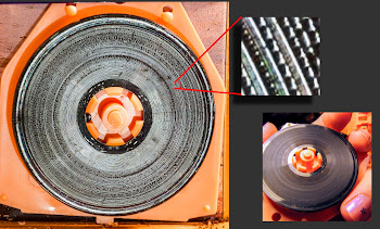

I'm using a photo of Tommy's internal miniature record I already had from previous adventures. This way, Tommy is spared from another invasive operation, though it also means I don't have control over the photographing environment.
The picture was taken with a DSLR and it's an uncompressed 8-bit color photo measuring 3000 by 3000 pixels. There's a fair amount of focus blur, chromatic aberration and similar distortions. But at this resolution, a clear pattern can be seen when zooming into the grooves.
This pattern superficially resembles a variable-area optical audio track seen in old film prints, and that's why I previously tried to decode it as such. But it didn't produce satisfactory results, and there is no physical reason it even should. In fact, I'm not even sure as to which physical parameter the audio is encoded in – does the needle move vertically or horizontally? How would this feature manifest itself in the photograph? Do the bright blobs represent crests in the groove, or just areas that happen to be oriented the right way in this particular lighting?

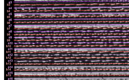

It's not easy to automatically follow the groove. As one would imagine, it's not a mathematically perfect spiral. Sometimes the groove disappears into darkness, or blurs into the adjacent track. But it wasn't overly tedious to draw a guiding path manually. Most of the work was just copy-pasting from a previous groove and making small adjustments.
I opened the unwrapped image in Inkscape and drew a colored polyline over all obvious grooves. I tried to make sure a polyline at the left image border would neatly continue where the previous one ended on the right side.
The grooves were alternatively labeled as 'a' and 'b', since I knew this record had two different sound effects on interleaved tracks.
This polyline was then exported from Inkscape and loaded by a script that extracted a 3-7 pixel high column from the unwrapped original, centered around the groove, for further processing.
