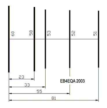

fusername Posted June 15, 2014 Report Posted June 15, 2014 (edited) //LE: Am gasit si schema ei: http://www.qsl.net/eb4eqa/bt_yagi/plans.gifPlacuta este scoasa din asta: http://www.tp-link.com/lk/products/details/?model=TL-WN7200ND Edited June 15, 2014 by fusername 1 Quote

Undeath Posted June 16, 2014 Author Report Posted June 16, 2014 Cu cateva scheme rezultate dintr-o practica indelungata (se folosesc DOAR materialele subliniate) si cateva calcule, va puteti confectiona o antena care deseori va poate uimi prin rezultatele date, uneori comparabile cu rezultatele oferite de o antena profesionala din comert Quote
