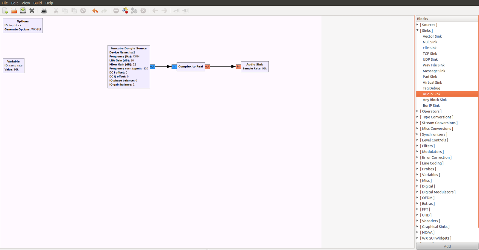

Although we've decided against using the USRP, it's companion software, GNU Radio, is the obvious choice. It has a great helper tool called GNU Radio Companion which makes this kind of task an absolute doddle. There is a plugin for the FunCube which is now bundled with the main GNU Radio distribution, so no extra work is required to get it up and running.
Firing it up, we can build a simple setup that connects our funcube to our speakers:
and again, if we run it, we get some nice 'data' sounding output... So we can hear it, and it sounds like data, but we still can't do anything useful with it. Saving it to a wavefile is just as easy:

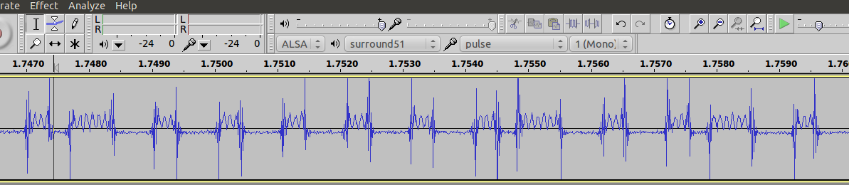

and now this is where the fun begins. We can edit that file with any audio editor. I used Audacity but pretty much anything will do.
We can clearly see our data bursts, and if we zoom in:
we can see some proper structure to it. This not only sounds like data but it looks like it too. What we appear to have is long pulses and short pulses, so we can imagine they may represent 0s and 1s just as they are - maybe a short pulse is a 0 and a long a 1...

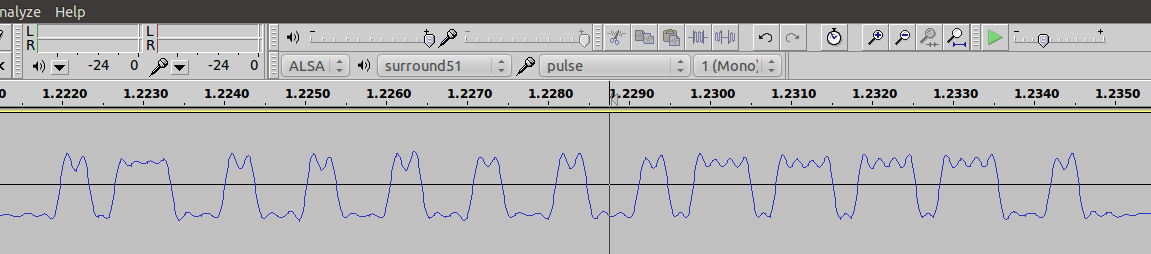

Now I know I said I wasn't interested in understanding radio, but there is one little thing that will help to convert our data from it's current analogue form into proper digital, and that's modulation. There are many modulation schemes out there, but the two you're most likely to encounter at this level are FM (Frequency Modulation) and AM (Amplitude Modulation). FM is normally used for things that need reasonably high fidelity, like speech or music, but AM, although it can also be used for speech and music, is perfectly suited to binary data as all it needs to be is either 'ON' or 'OFF'. This is also known as OOK, or On-Off Keying, and as we can see from our sample, this is clearly what we are dealing with here. We have a flat line when we're 'OFF', which then becomes wavy when we're 'ON'.
Now we know we're dealing with AM, we can get GNU Radio to do one more job for us: demodulate the AM signal.
And our signal now looks like this:
Now, instead of bursts of wavy stuff, it's pretty much a straight line that goes high or low which is very clearly binary data. We have long pulses and short pulses, and the whole sample is simply this short pattern repeating. If we assume the short pulse represents a 0 and the long a 1, this decodes as:

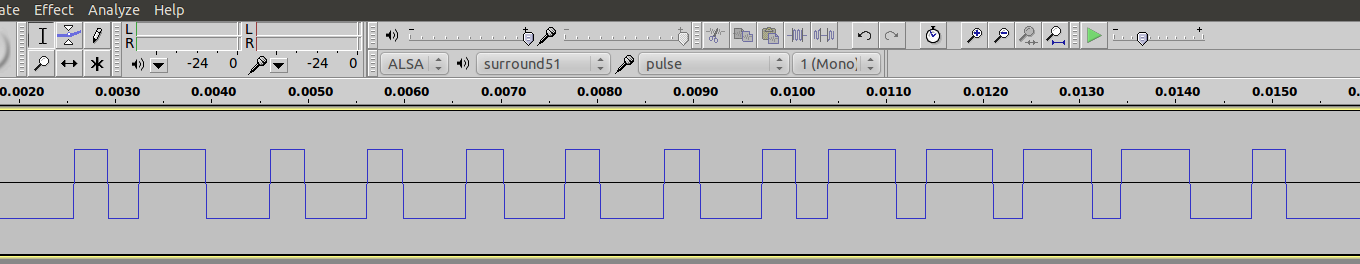

Looking at the original trace, it's pretty 'readable', but If we want to really tidy it up we can turn it into a square wave and this will make visual checking of bit lengths much easier and more accurate. Since a .wav file is just a header with a bunch of values for each sample, it's really easy to manipulate. In this case we want to take any value that is below 0 and set it to absolute minimum, and anything above 0 we set to maximum, which is effectively what the original source was doing before the signal got converted and sent over RF - a 0 was a pin going LOW and a 1 was a pin going HIGH...
Accordingly, I wrote a little command line tool for tweaking wav files:
[/FONT]$ wav-cli.py /tmp/test1.wav square 0 out /tmp/ts.wav
Converting to square wave
Writing /tmp/ts.wav
[FONT=Arial]
and this is the result:
Now we can accurately convert the signal into true OOK binary. We take the smallest element as our single binary digit, and then represent the data with a 1 when we want the line to go high, and 0 when we want it to go low, taking into account the size of our pulse compared to the single binary digit. In this case we only have two different size pulses - short and long, so we can represent them with a single or double digit:
Again, we need to add some leading or trailing 0s to give ourselves an 8-bit multiple, so the final number we end up with is 00101100 10010010 01001001 01101101 10110010, or 2C 92 49 6D B2 in HEX. Since it's always the same, we don't really need to understand what this message 'means', only to be able to reproduce it.
