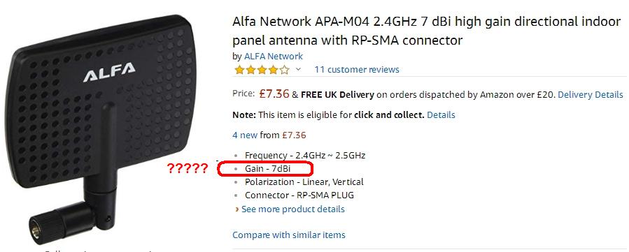

fbob Posted November 3, 2018 Report Share Posted November 3, 2018 https://www.amazon.co.uk/Network-AWUS036NHA-Adapter-150-Mbps-802-11b/dp/B004Y6MIXS/ref=sr_1_fkmr1_1?ie=UTF8&qid=1541268005&sr=8-1-fkmr1&keywords=alfa+nha daca ai o rete in special, poti folosi asta ca si directionala: https://www.amazon.co.uk/Network-APA-M04-directional-antenna-connector/dp/B003ZWILOW/ref=sr_1_2?s=computers&ie=UTF8&qid=1541268043&sr=1-2&keywords=alfa+apa Quote Link to comment Share on other sites More sharing options...
CD-RAY Posted November 4, 2018 Report Share Posted November 4, 2018 ,,,decit sa cumperi antena aia, mai bine-ti cumperi o bere .....si-ti faci asta la Alfa... Quote Link to comment Share on other sites More sharing options...
fbob Posted November 4, 2018 Report Share Posted November 4, 2018 4 hours ago, CD-RAY said: ,,,decit sa cumperi antena aia, mai bine-ti cumperi o bere .....si-ti faci asta la Alfa... asta trebuie sa o faca in transmisie, nu in receptia semnalului . si oricum, are acelasi efect ca si cand ai intinde un cearsaf pe masina cand bate vantul, sa nu consumi carburant.. 1 Quote Link to comment Share on other sites More sharing options...
CD-RAY Posted November 4, 2018 Report Share Posted November 4, 2018 (edited) ,,,cea mai buna forma de .... ,,,daca este Beer Can big,cistigul antenei se mareste...!!! Edited November 4, 2018 by CD-RAY Quote Link to comment Share on other sites More sharing options...
fbob Posted November 4, 2018 Report Share Posted November 4, 2018 sper ca iti dai seama ca improvizatiile astea mergeau acum +10 ani. daca te uiti la data la care au fost postate porcariile alea, ai sa realizezi ca sunt maxim din 2013. dar in 2013 veneau postate doar pt trafic P.S. sa nu'mi spui ca esti vegetarian 1 Quote Link to comment Share on other sites More sharing options...
CD-RAY Posted November 5, 2018 Report Share Posted November 5, 2018 (edited) ,,,vorba multa,saracia omului...!!!! Edited November 5, 2018 by CD-RAY Quote Link to comment Share on other sites More sharing options...
fbob Posted November 6, 2018 Report Share Posted November 6, 2018 Daca nu iti permiti sa iti cumperi un dongle la care sa imbini o antena eficienta, continua cu folie de aluminiu sau cutii de bere. Dar nu ai sa poti niciodata demonstra ca functioneaza mai bine decat produsul oficial. Esti exact ca aia de pe forumurile cu masini. Nu au avut niciodata mai mult decat un clio la mana a doua, dar comenteaza de masinile noi "ca nu sunt bune, ca nu renteaza" si asa mai departe.. 1 1 1 Quote Link to comment Share on other sites More sharing options...

xzsdyx Posted November 6, 2018 Report Share Posted November 6, 2018 Se pot vedea imbunatatiri cu folia de aluminiu daca orientarea antenelor este corecta(atat pentru Rx cat si pentru Tx). Cu toate astea, randamentul este mai mic decat o antena construita cu caracteristici directionale. In plus, din cate stiu metoda cu folie de aluminiu nu este recomandata(probabil pentru ca nu este deloc eficienta) cand se foloseste tehnologia MIMO (adica cand sunt folosite mai multe antene pentru AP). Ideea foliei este de a creste castigul antenei, transformand o antena omnidirectionala in una usor directionala asemanatoare antenelor parabolice. In principiu, ai nevoie de un adaptor WiFi care are o antena cu un castig mare(antena directionala) pe care sa o orientezi catre sursa semnalului (catre AP/hotspot). Cele de la Alfa sunt bune in general. Daca sursa semnalului nu e foarte departe (daca deja prinzi o linie pe laptop inseamna ca nu este foarte departe) atunci o antena cu un castig de 7 dBi este suficienta. Daca vrei sa ai acces la distante si mai mari, exista antene yagi cu un castig in jur de 25dBi dar care sunt mult mai sensibile la orientare dar si mult mai scumpe(din cauza directivitatii crescute). Ideea cu castigul e simpla. Castigul arata cum este focalizata energia semnalului. 0dBi reprezinta o antena omnidirectionala pur teoretica care radiaza energia in mod egal in toate directiile posibile (daca vrei sa vizualizezi, in plan 2D este energia radiata in mod egal la 360 de grade). Cu cat castigul creste, cu atat energia este orientata mai mult in anumite directii si mai putin spre deloc in altele ( daca castigul tinde la infinit, forma ar arata ca o linie intr-o directie arbitrara). Doua antene cu acelasi castig pot fi diferite deoarece producatorul alege arbitrar directia in care focalizeaza energia semnalului. Pentru a vizualiza cum este distribuita energia antenei cauta diagrama directivitatii in fisele tehnice ale antenelor. Recomandarile lui fbob sunt bune(atentie, prima recomandare reprezinta un adaptor WiFi iar cealalta recomandare o antena care poate fi atasata adaptorului respectiv). 1 Quote Link to comment Share on other sites More sharing options...
